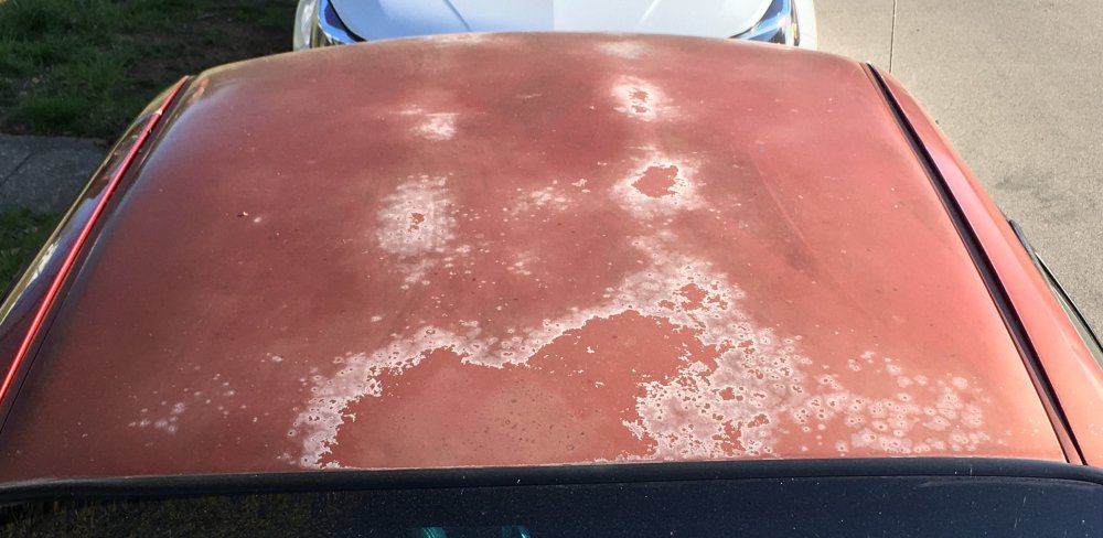

I've got this '02 Taurus that has aged unusually badly on the hood roof and trunk top, and if I can just get these parts addressed the car will look so much better.  I'm not aiming for anything close to perfect...just trying to make these look better so your eye isn't drawn right to them.  Rest of the body's paint isn't bad at all.
Hopefully what I'm seeing here is just the clear coat failing and all it needs is a sanding, 2k clear applied, some high grit sanding, and buffing.  The directions I've found so far are to first sand with 600 all over and especially over where the edge of the clear is peeling up.  Clear coat, sand with 1500, then buff.  Sound about right?  If it's so far degraded that it actually needs some color work, it's ok I'd rather not deal with that part.  I just want to throw about $100 bucks at it and if it looks better then I'll be happy.
Any suggestions on how I should approach this?  Thanks.

I once bought a paint gun to paint a hood on a jeep I was restoring. I found it fun, and it looked amazing when I was done. But I also value my time, so I pay the $350 to let the body guy next to me do it.

Last thing.  If I order some base color coat from touchupdirect, do I have to use THEIR 2K clear or can I use a different brand like Dupli-Color?
