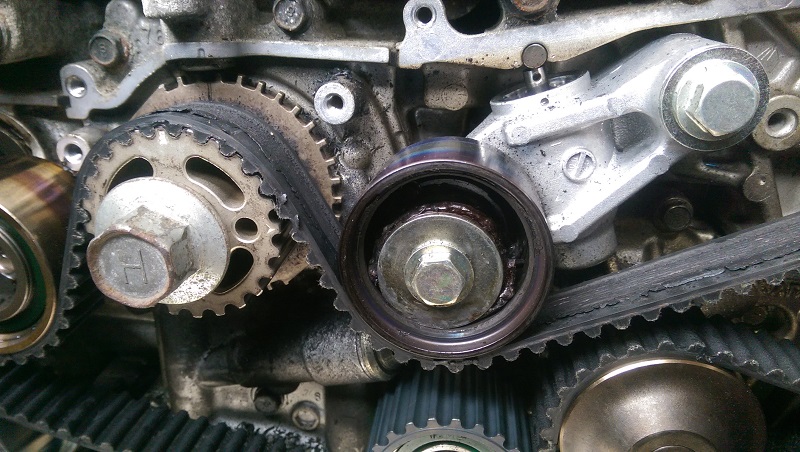

Just ran into a serious issue that I want to give you guys the heads up on before it costs you a big headache. The last two Subaru timing belt jobs we did used Dayco kit, the tensioner bearing failed. The first one was after 39 miles, the second one only lasted 19 miles. These were sourced through Advance. Looks like the second one may have cost the engine.
I'm waiting to hear back on what happened in the manufacturing process that caused the failure. We have installed tons of these kits with no troubles and have two failures in a row now, something has gone sour.
Save yourself the headache, skip the tensioner or install OE on this one. Will post back with more details once I get an answer.

Spent a bunch of time with Dayco rep and engineers on the phone yesterday. They claim an NTN tensioner in the box, which is OE, got a new tensioner from Subaru, it is NTN, so is the Dayco one, but they are clearly different parts, different castings and everything. I can only assume NTN changed something in production or they make a different part for aftermarket. The other pulleys that come in the kit are GMB and they are identical to OE. We put OE tensioners on in place of failed ones and all is well, we got lucky with the motor that went out of time, thankfully Subaru's can be out quite a bit before interference.
I have mixed feelings about the product now, this is the only timing component failure we've seen. We switched over to Dayco from Gates only about a year ago. I'm not ready to say I won't use Dayco timing kits but I will certainly scrutinize kit components before install.
